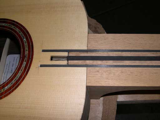

How do you hold down the fret board over the body in your bolt on system?
Thanks.
Jeff
PostPosted: Wed Jun 15, 2005 3:29 am
Posts: 886
Jeff I've provided pictures of it before but essentially I have two CF rods that come out of the neck and float down to support the tongue, that part of the fingerboard actually floats just above the top of the guitar.
Here's a picture of what it looks like without the fingerboard:
Those two rods are then glued to the tongue, when I set my neck angle it just barely floats out over the top.
-Paul-
